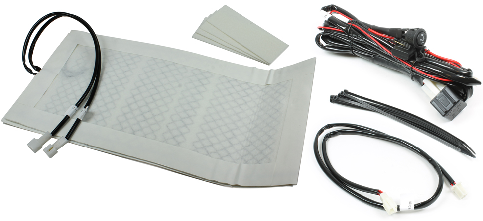

  • Hier das sind "ROSTRA".......Ab ca. 125.-USD = 115.-€
    Es gibt 4 verschiedene Modelle ....Hier schlau machen ..Auch in deutsch einstellbar .. ;) ...
    New automotive seat heating system by Rostra
    Installing a vehicle seat heating system has never been easier than with Rostra's 250-1900 system.
    www.rostra.com
